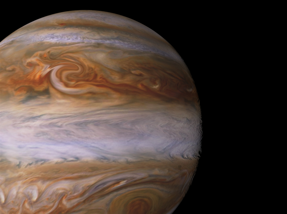

This is my first test render of Jupiter using an animated 4k texture map I made using PS and AE.\
And here is the frame I posted before of part of the flythrough of the MilkyWay Galaxy.
Message edited by Marinello2003 on 12/20/2012 - 11:36 PM
