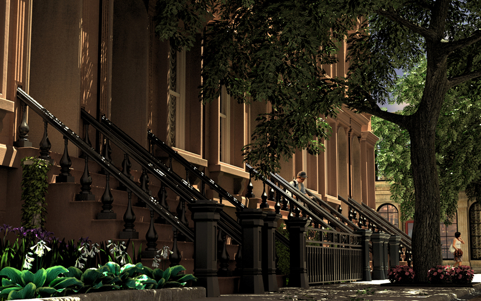

Just another Pic of my interest in townhouses. Would like to have set the camera to a deeper perspective but the distortion was unacceptable.

How was the image distorting when you used a wider angle of view, widening the view-point shouldn't effect the lens distortion parameter.

Did you tried to shift the lens ?
Thanks for the interest. The white lines on the image shows what I am talking about as far as distortion.
To get it this far I used a 1 degree roll on the camer and rotated on the z axis by 1 dgree. This made the step posts a little straighter and the end of the block profile on the houses more verticle.
You need to set the camera's X rotation to 0 to remove the perspective distortion, then use FILM OFFSET X and Y to get what you want into the frame.
Note: I see you are using a camera target which prevents you from controlling the camera rotations. I think you will have to disable the targeting for this trick to work
Brad has a video on luxology.tv here
