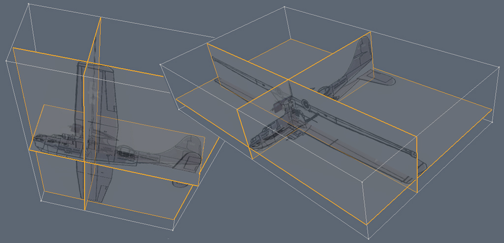

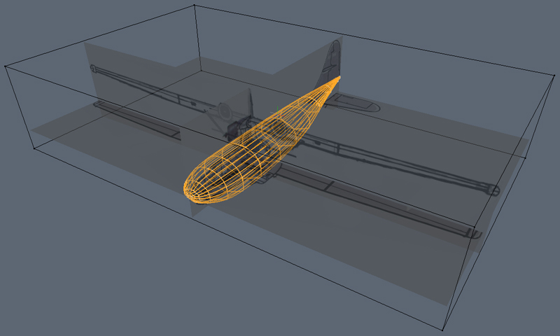

I just got started on this aircraft model for a new group project.
Just a bounding box, backdrops, and rough fuselage so far...
-Jeff

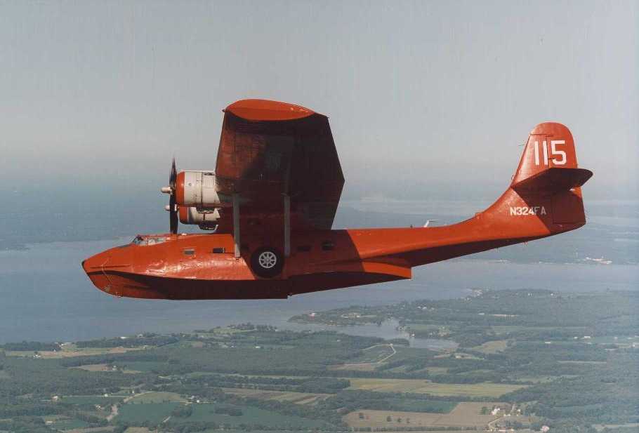

texturing is way off, as you can see from the reference image, there are NO orangy wireframe lines present. I would re-evaluate your work to make it more realistic. Also try lowering the shading rate component.
Seriously though, I'd love to see how this goes. I have a thing for planes, but I won't admit it.

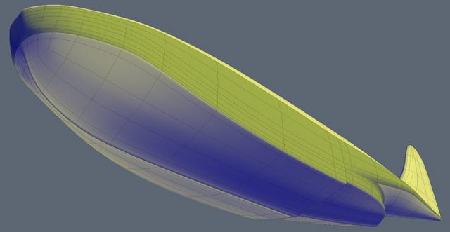

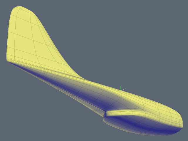

Jeff Rutan
rating: signal +1 signal
San Diego, CA USA
2150 posts
Yazan - Ha Ha ;-)
I sent an email to sdmodo members asking for hotel advice. I will pass along anything I get as I am not too knowledgeable about local hotels.
We have an sdmodo meeting this coming Monday evening, so I will ask there too.
My personal email address is: jeffrutan at mac dot com.
LRoy - Thanks for the encouragement - really helps to keep at it when lots of other things to do!
Grant: Yes - I remember - please finish your spruce goose! I was following that with interest a long time ago. The red civilian conversion model shown above is only one of many reference photos I am using for shape, not final finish. My final model will be a US military version with white belly and dark blue top.

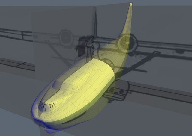

Here is a small update with some fuselage refinement and a tail...
-Jeff

phunkidude
rating: signal 0
Name: Sean Sykes; Location: An unregarded little blue-green planet far out in the uncharted backwaters of the unfashionable end of the western spiral arm of the galaxy
771 posts
Jeff,
not the best of refs but this may help:
http://www.the-blueprints.com/modules/bpview/bpview.php?nr=2105
No extra canopies on yours though.

http://dominique.goupille.free.fr/meeting/catalina0002.JPG

Phunkidude: Thanks! I got some great blueprints (see the backdrops in my first post in this thread) and plenty of great reference photos using Google Images. Mine will have the extra canopies - I will add those later - I am trying to get the basic fuselage shape just right before moving on to any details.
Pierre: Thanks! I didn't have that great image yet! It really shows some fine details in the front.

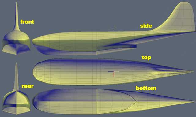

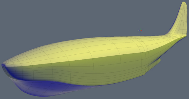

Jeff Rutan
rating: signal +2 signal
San Diego, CA USA
2150 posts

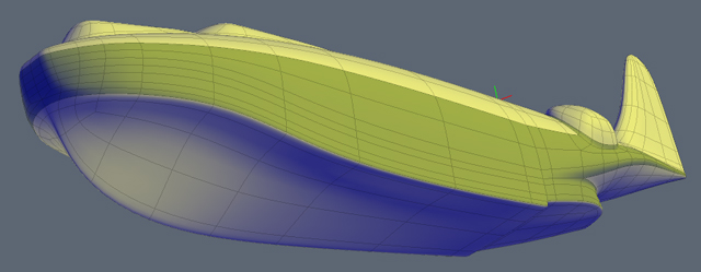

Just some fuselage tweaking...
-Jeff

grantm
rating: signal 0
South Africa
1507 posts
Ah, I'm glad you're still working on this Jeff, I was just about to come and poke you with a pencil.
Looking great, but I don't think the underside is quite right. Your keel line appears to be pulled down slightly into a small point (in the front/rear view), along most of its length I think the lower part of the 'V' should be harder/straighter. At the widest point of the hull it's only the top which curves out towards the sides. At the front the underside should be quite concave.
Front:
http://www.seawings.co.uk/images/Plane%20Sailing%20Cat%20Walkround/270.JPG
Rear:
http://www.seawings.co.uk/danecat31.htm
4/29/2007 - 1:40 AM

Jeff Rutan
San Diego, CA USA
2150 posts
Grant, Thanks! You are right on both accounts. The reference shots I picked to stare at while shaping the hull were from lower underneath and it appeared to me to have the features I modeled, but looking closer at some other references and especially the 2 you referenced here it is obvious I missed those facts. I am also noticing that there are some very significant differences between different versions of this same plane in construction details - not just the gun turrets, but shape of the tail, nose and even significant surface details. Obviously I need to go take some detailed reference photos of my own of the real one I am trying to model.
Unfortunately I am not finding much time to work on this, but I am committed to finishing it in the next couple of months. More tweaking to do before moving on, but here is an update...
-Jeff

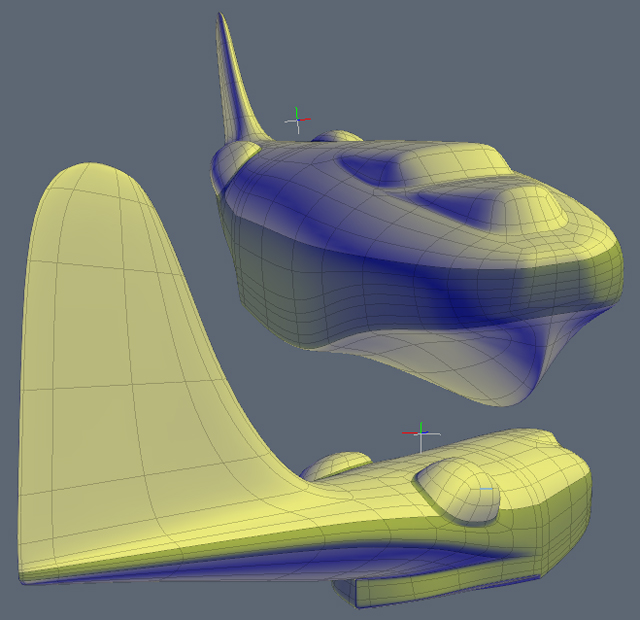

Jeff Rutan
rating: signal 0
San Diego, CA USA
2150 posts
I am having difficulty trying to figure out how to model the window panes in the side blisters. Cuts to sharpen the corners of the frames tend to pull up, pinch and distort what should be a smooth rounded teardrop shape. I may just do the frames as a separate piece from the glass, but I would like to learn how to do this as one piece if I can. I really want to keep the geometry simple, low poly, no edge weighting and preferably all quads (although I have already strayed from all quads in these examples trying to smooth things out).
Any advice?
Thanks,
-Jeff

voigtlander
rating: signal 0
NC (USA)
389 posts
Quote from Jeff Rutan :
Any advice?
Thanks,
-Jeff
IMHO if you want low poly and sharp crisp edges you have a lot of work ahead of you in a unified SDS mesh. That will by its nature be a fight/struggle to the death. Maybe rethink your goal, if it must be modeled detail do them separately - far more efficient and clean. Or to stay pure low poly in SDS and treat them as UVed textures on the simple base geom. My 2cents.

Gardner
rating: signal 0
San Diego
314 posts
Forget the low poly man. What do you have all the RAM for anyway? :) Slice it. Dice it. Under 1 million is low poly baby. You oughta see the Wristwatch tutorial. No worries about one mesh there and that's just a tiny watch. Looking good.
-Gardner
